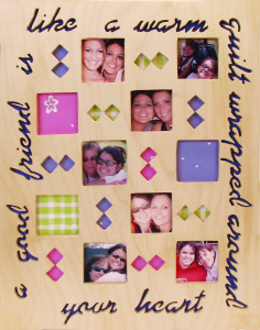

Make a fun gift for a friend or special keepsake for yourself. This fretwork frame has a cozy message and spaces for 10 photos, accented with splashes of your school, team, or favorite colors.
The pattern is very versatile. I taped my photos and scrapbook paper embellishments to the back, covered them with fun foam to keep everything secure, and added a hanger. You could also skip the foam and slide the wood into a frame or attach it to the front of a scrapbook. You could even cut a bottom and sides, and build a box to hold your treasured memories. Scroll down for the pattern link. I hope you and your friends enjoy this project!

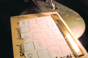

• To help cut straight lines on the inside of the picture frames, use wide tape to attach a metal ruler to the pattern along the line that you want to cut. Cut from the blade-entry hole to the corner and then continue down the line of the ruler. Stop when you get to the next corner and reposition the ruler. Move the blade back to the hole and cut the next edge. This technique helps with making square corners.
