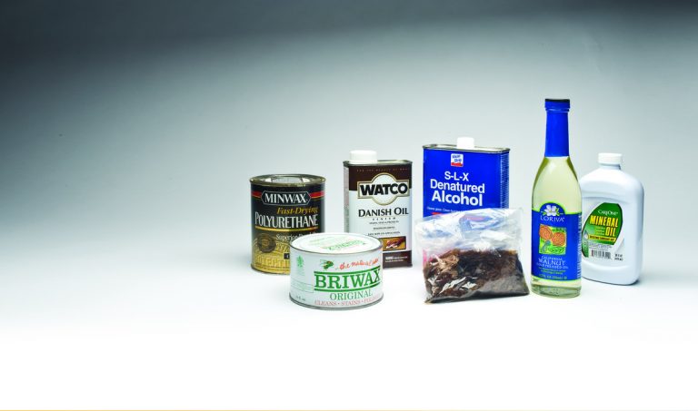

Finishing

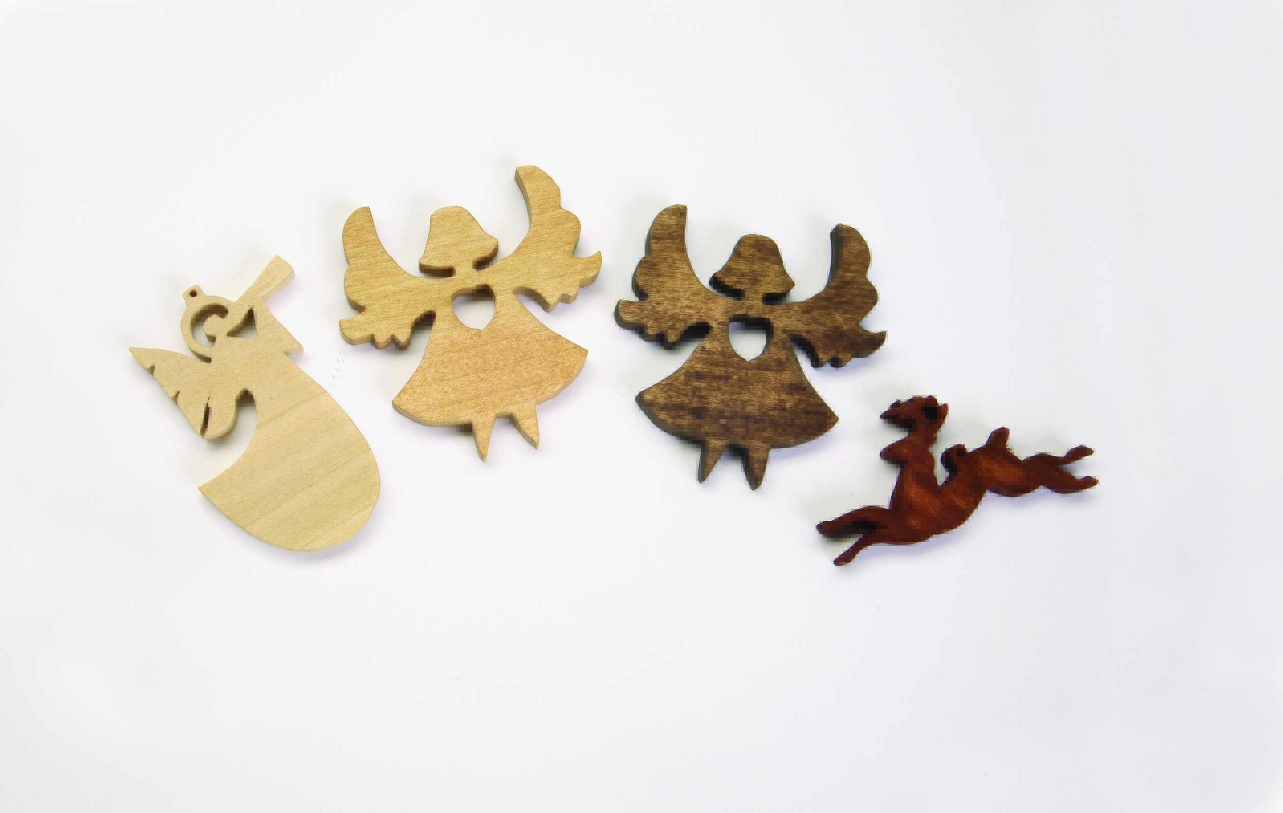

Hickory takes a finish well. Since it has a coarse texture, you may need to use a finer grit than normal for the final sanding. This will help the finish to be absorbed at the same rate across the entire piece. Oil finishes work well, and hickory heartwood stains well. The sapwood, since it is already a darker color, doesn’t stain as well.
