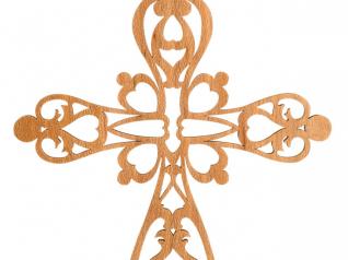

The large open frets and sweeping curves make this beautiful cross a good project for both novice and experienced scrollers. The design allows you to make large blade-entry holes to minimize time spent threading the blade through tiny openings.
Cut the cross from ¾”-thick hardwood for a striking wall hanging or choose ¼”-thick stock and add a contrasting backing board. Mount the cross on a solid piece of wood and enclose the project in a frame for a stunning shadow-box effect, or cut the frets first and stack a piece of contrasting wood or colored acrylic with the cross blank when cutting the perimeter. The colored acrylic produces a stained-glass effect perfect for display in a sunny window. Apply an oil finish to the project and glue the contrasting backing board or acrylic to the fretwork with cyanoacrylate (CA) glue.
