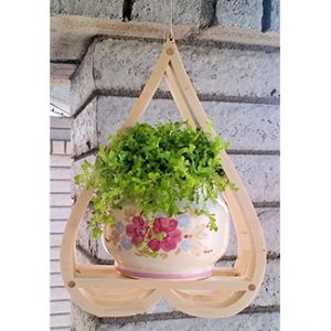

Attach the patterns to the two wood blanks. Drill the indicated holes and then drill blade-entry holes for the frets. Cut the frets and then cut the perimeter of the plant hangers. Cut the dowels to length. Sand everything smooth. Glue the dowels into the appropriate holes. Apply a finish of your choice; I use clear spray varnish, but exterior paint works, as well. Thread a string through the top holes to hang the hanger. Place a potted plant on the flat surface of the hanger.
