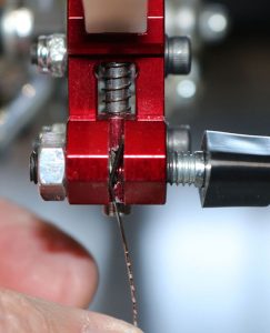

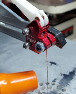

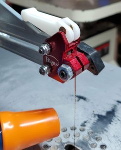

The Problem: The clamps won’t hold the blade.
The Fix: Most scrollers tend to overtighten the clamps and, if a blade slips, tighten the clamps even more. On popular scroll saws, over-tensioning the clamp screw will spread the jaws to a point where they must be replaced. Generally, using just an index finger and thumb is enough to sufficiently tighten the thumb screw against the blade. Too much blade tension can also cause the blade to slip or break prematurely.
TIP

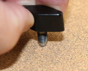

Clamp Screw Maintenance
Remove the thumb screw. Gently rub the end back and forth a few times over medium-to-coarse sandpaper. Reinstall the thumb screw back into the clamp. Insert the blade and start cutting. If the blade continues to slip, repeat the process. You may need to repeat the process for both top and bottom clamps. If the blade still slips, check the clamp for spreading on the metal head. If this is damaged, the method will not work, and the clamp assembly will need to be replaced.

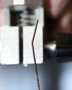

The Problem: My blade keeps bending.
The Fix: A bent blade—or, as I call it, the hockey stick effect—is normally caused by the set screw sitting too deeply in the clamp body and, therefore, not touching the blade. Repositioning the set screw and clamp screw so they fall at the exact middle of the clamp will eliminate this problem. If the set screw is not positioned properly to hold the blade against the clamp screw, the blade will bend and most likely slip out of the clamp.

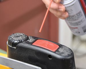

The Fix: Saws are notorious for collecting sawdust in the power switch which causes them to not turn on. Blow the switches out with a can of compressed air. If that doesn’t work, try plugging the machine into a different outlet. Check to see if the fuse has blown. If the fuse blows a second time, the saw should be serviced.
Use a can of compressed air to clear dust out of the switch.

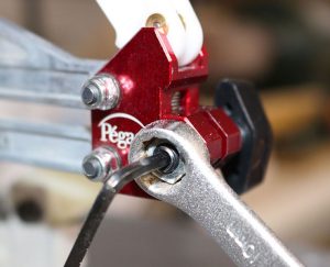

TIP
Adjusting the Set Screw
Use a 3/8” (10mm) wrench to loosen the set screw nut. Then use an Allen key to adjust the set screw to a desired length. Retighten the nut to hold the set screw in place.

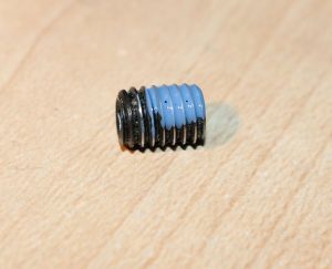

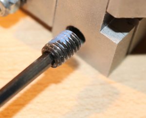

The Problem: My set screw is always loose.
The Fix: A dab of Loctite® Blue works well to hold a set screw in place, yet still allow you to adjust or remove it, if needed. Note: Do not use Loctite Red for this application, as it will permanently hold the screw in place. Many have had success securing a set screw by using a dab of nail polish, wood glue, or a drop of lacquer. Experiment to see what best works for you, but do not use anything with a permanent hold.
A small dab of Loctite Blue will seat the set screw securely.

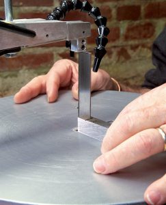

The Problem: I don’t know how to square the table.
The Fix: Most scroll saws have an adjustable table that allows you to make cuts at different angles. There are times when you want your saw set at an angle, but most cutting is done with the blade perpendicular to the table. If the table is even slightly off-square, your cuts will be angled. This interferes with puzzle pieces, intarsia, segmentation, and many other scrolling projects. The most common method for squaring your table is the small square method. Set the square flat on the saw table against a blade that has been inserted and tensioned. Adjust the table to form a 90° angle to the blade.

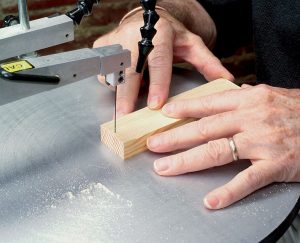

The cutting-through method is also popular. Saw through a piece of scrap wood at least 3/4″ (1.9cm) thick, and then check the angle of the cut using a square. Adjust the table until you get a perfectly square cut. You can also use the kerf-test method. Take a 1 3/4″ (4.4cm)-thick piece of scrap and cut about 1⁄16″ (2mm) into it. Stop the saw, and then spin the wood around to the back of the blade. If the blade slips easily into the kerf (the groove you just cut), the table is square. If it doesn’t slide into the kerf, adjust the table and perform the test again until the blade slips.
Small square method.
Cutting-through method.

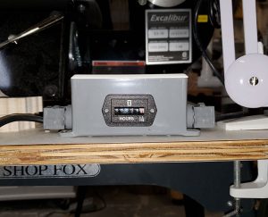

Monitor Your Machine
Keep track of the hours that you put on your saw. Some saws require certain maintenance after a certain number of hours. For example, the Hawk® G426 calls for fresh application of WD-40® every 50 hours of use; the Hegner calls for lubrication every 10 hours. Check your saw’s manual for where to apply.

An aftermarket hour meter will measure the usage of your saw.
