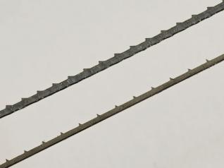

The smaller teeth and wider gullet on the Olson Mach Series blade (bottom) produce a smoother and straighter cut.

The new Mach Series scroll saw blades by the Olson Saw Company provide a middle ground between Olson’s Precision-Ground-Tooth (PGT) design and ordinary scroll saw blades.
The Mach Series blades, like most scroll saw blades, are milled, which makes them more economical than the “ground” PGT blades. But the blade shape, according to Chuck Olson, owner of Olson Saw Company, is based on the PGT design. This makes the Mach Series nearly as aggressive as the PGT blades, and they provide a similar straight cut. Ordinary milled blades tend to drift to one side as you cut because of a burr created during the manufacturing process.
“We wanted to make the tooth tip sharper by changing the back angle of the tooth. This widens the space between teeth, which provides greater chip clearance and reduces drag for faster cutting,” Chuck said. “We believe these factors contribute to the way the Mach blades cut straighter than regular milled blades.”
