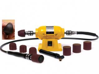

The Guinevere Sanding System by King Arthur Tools claims to be the smallest inflatable sanding drum. What the tool lacks in size it more than makes up for in power.

The Motor Unit
The small motor unit, which looks like a mini-version of a bench grinder, features a powerful ½ hp motor. This little motor really packs a punch. Both sides of the motor feature a traditional three-jaw chuck, allowing you to chuck two different shapes of sanding drums or two different grits of sandpaper.
Both chucks rotate downward, which gives you additional control and allows you to easily see how much wood you are removing. The motor rotates at around 3,600rpm. The tool produces a lot of dust, especially when equipped with coarse-grit sanding drums.

What separates the Guinevere from other sanding drum setups is the optional flexible shaft. Foredom set the standard for flexible shaft machines, but Foredom tools revolve much faster, usually around 18,000rpm. Slower is better when it comes to sanding and polishing. In many cases, sanding at high speeds will clog the sandpaper and burn the wood.
The flexible shaft for the Guinevere attaches to the three-jaw chuck on the right side. The 51″-long flexible shaft bends easily to make the tool easy to use. There are three separate bearings in the shaft assembly (one in the shaft itself, and two in the handpiece), which contribute to the tool’s smooth operation.
When testing the shaft, I equipped the 2″-diameter by 4″-long cylinder-shaped drum with 60-grit sandpaper and started sanding the edge of a piece of ¼”-thick oak. In 20 seconds, the tool removed 5/32″ of wood. During the time test, I pressed the wood and drum together as hard as I could and the motor only started to bog down at the 20 second mark. Neither the shaft nor the motor faltered. More importantly, the tool did not burn the wood at all.
The Sanding Drums
The drums are inflated using a small but powerful hand pump. Usually, a short stroke of the pump is all that is required to create firm pressure in the drum.
King Arthur Tools has created four different drums for the Guinevere. The main kit comes with a 2″-diameter by 4″-long cylinder-shaped drum and a 2″-diameter round-nose drum. Equip one of the drums with coarsegrit sandpaper to remove wood fast and use medium-grit sandpaper on the other drum to add details and remove scratches left from the coarse sandpaper.
I suggest you add the optional dust collector for the flexible shaft if you plan to use it often. The dust collector attaches right to the flexible shaft. A flexible hose connects the collector to a shop vacuum. Even when sanding aggressively with coarse sandpaper, the collector trapped 90% of the dust.
There are also 1″-diameter by 4″-long cylinders and 1″-diameter by 2″-long cylinders available for detail sanding. There is a polishing kit available if you prefer to polish the wood and apply a wax finish.
