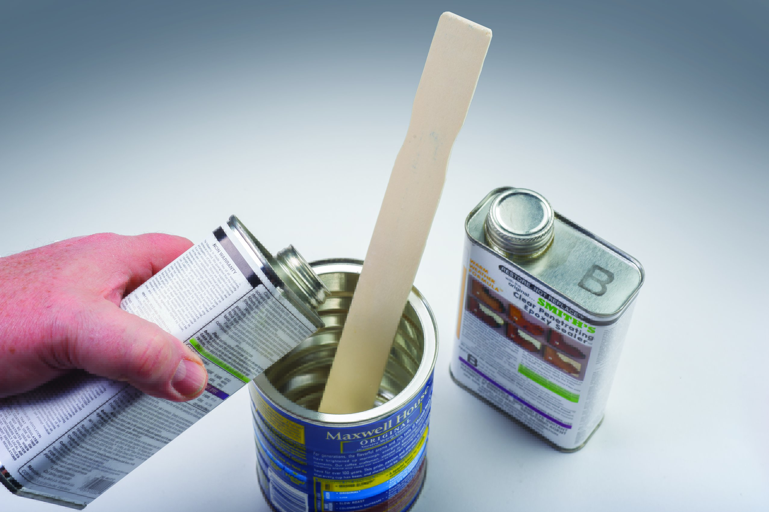

The most effective outdoor finishes and glues must be mixed before using.

A few years ago, Fine Woodworking magazine did extensive testing of clear outdoor finishes. They found that clear penetrating epoxy sealer (such as Smith & Co.’s CPES) under a high-quality spar varnish, such as Epifanes (www.Epifanes.com) lasted the longest.
According to Steve, the best way to maintain a proper thickness for the varnish, after sealing the wood with a penetrating epoxy, is to use a quart of varnish for each 20 square feet of wood. If you use Epifanes and CPES, Steve says that when you go to refresh the finish with another coat of varnish after five years, you can double the coverage area of that quart to 40 square feet.
