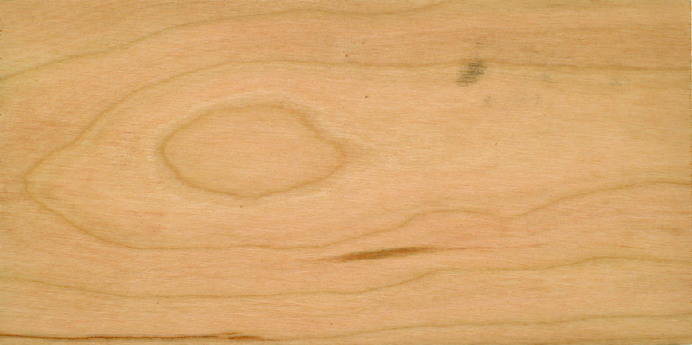

Holly is a very white wood, but it can sometimes have a few blue streaks in it. The heartwood and sapwood are almost identical. Even though other woods yellow with age, holly tends to stay white. It is ideal for white parts in intarsia, or for other white details or projects—such as holiday ornaments.
Holly is not a wood that you can pick up at a home improvement store, but many hardwood dealers carry it. Prices range from $10 to $30 a board foot, which makes it a more expensive wood. Charlie Self, author of Woodworkers Pocket Reference, suggests looking for holly someone has cut down while clearing land; it’s a relatively common wood on the East coast. It is usually found as a shrub, but can grow large in the wild.

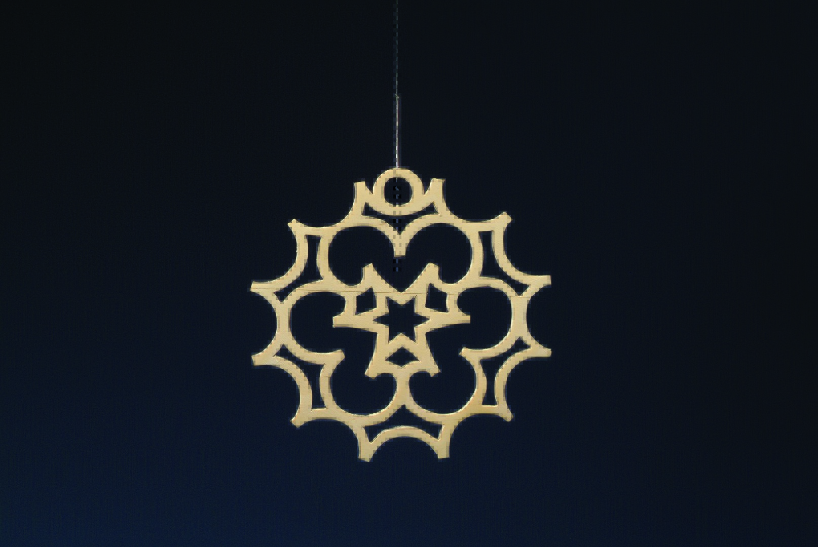

When cutting holly, I noticed that it has a slightly wild grain. While the grain can be very hard to see, it does tend to loop back upon itself. If you are using the holly as a solid piece, for intarsia or inlay, for example, this is not a problem. But you need to be aware if you are cutting fretwork. I tried to cut the Peace Sign on page 44, but the holly broke apart when I was cutting my second fret. After examining the section under my magnifier, I saw that there was a small grain direction change in the wood between frets. It wasn’t visible to the naked eye, but under magnification, it was clearly visible. Pay particular attention to the orientation of the pattern on the work piece.
Holly sands to a polished finish. For the ornament above, I sanded up to 600-grit. Even before applying a finish, the wood shined.
