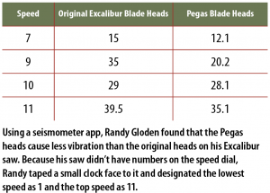

In addition, Randy used a seismometer app to examine the differences in vibration between his original Excalibur blade clamps and the Pegas blade clamps at various speeds. “I spent hours testing this, and the vibration was measurably less with the Pegas clamps,” he said. Data aside, however, Randy admitted that he didn’t notice much of a difference in vibration when he was focusing on a project.
