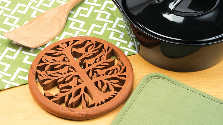

Fauna and Fowl Trivet
Folk art-style fretwork protects your table and decorates your kitchen
By John A. Nelson
Cut by Leldon Maxcy
This beautiful trivet is almost too pretty to cover with a hot pan or dish. The project is great for beginners and advanced scrollers alike, and anyone looking to add a special touch to their table setting.
Getting Started
Attach the pattern to the blank, drill blade-entry holes and the birds’ eyes, and cut the fretwork.
Cutting & Finishing
To cut the sharp corners in this trivet design, I suggest using flat blades. Choose a medium-tone or darker hardwood, such as cherry or mahogany; the darker wood hides any scorch marks from hot pots. Most film finishes, such as varnish or lacquer, will break down over time with the application of heat. I suggest Danish oil or another oil finish, which tend to soak into the wood and protect it without flaking off.
