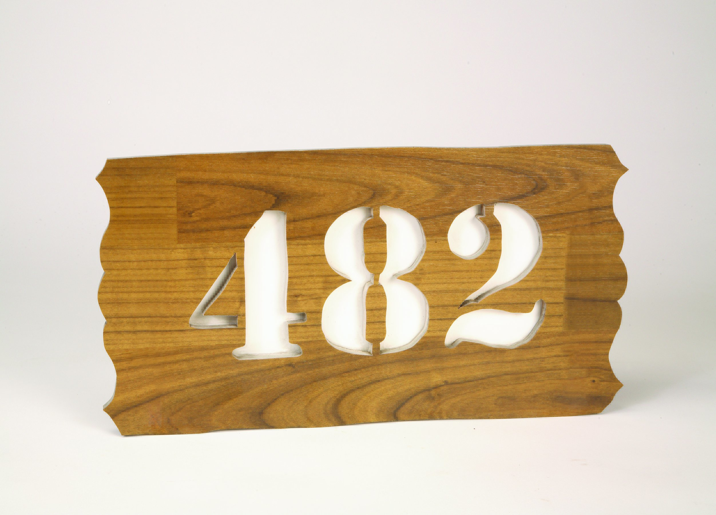

Since the material is pre-finished, it speeds up the process for many projects. There are several types of laminate flooring and the finish depends on the orientation of the laminations. Editor Shannon Flowers used a scroll saw to cut a house sign out of scraps of her kitchen flooring. The sign shows no wear after three years in the elements.
