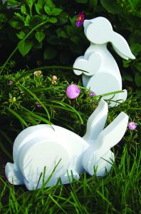

Layered Garden Bunnies
By Paul Meisel
These delightful bunnies are easy to create and make great gifts or sale items.
They are easy to make for several reasons. First, the shapes do not require precision cutting and, therefore, are very forgiving should you go outside the cut lines. Second, there are no inside cuts. Third, since they are painted all one color, they are easy to paint. These rabbits are an ideal beginning project for children or for those new to scroll sawing.
Picture having two or more of these cute animals displayed in your yard, in your garden, or even in a large flower pot.
