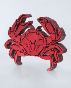

This multiuse design works well with many kinds of wood. I thought it would be fun to cut it from a piece of maple as a freestanding decoration or a gift for those born under the Cancer zodiac sign. Then, the editors asked my opinion on SpectraPly, so I cut a crab from that, as well. I have also experimented with it as a smaller design, cutting it out of 1/4″ (6mm)-thick hardwood for Christmas ornaments. Before finishing your crab, think about where your piece will be displayed and if it will be in direct sunlight. Then check out our exclusive article on how sunlight affects color and gloss.
Making the Crab
First, cover the wood with clear packaging tape. Attach a copy of the pattern to the tape. Drill the blade-entry holes and cut the frets. Save the exterior cuts for last. Be careful on the freestanding antennae; the veneer layers in the SpectraPly chipped on these as I cut. After you finish cutting, remove the pattern and hand-sand with 220-grit sandpaper. Apply an oil finish to bring out the color.
The standing crab
cut in red Spectraply plywood.
