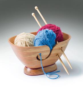

Scrolled Yarn Bowl
temp2bob-Yarn_Bowl_Lead_WEB_761124840Make your own bowl press and angle guide to speed up the construction process
