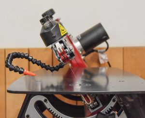

Like Excalibur saws, the Pégas features a tilting arm controlled by a rack and pinion system that allows you to dial in an angle quickly and accurately. It also has a spring-loaded locating pin and matching holes for common angles, such as 0°, 45°, and 221/2°, to make it even easier to orient the arm. (Follow the instructions in the owner’s manual to check these angles when you get your saw; after I squared my blade to the table, I had to adjust the angle guide and locating pin to zero it in.) And conveniently, Pégas put the power switch and speed control at the front of the saw arm.

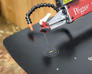

The table is large enough to support most projects, and since the saw arm lifts and stays in place, you can top- or bottom-feed when cutting fretwork. (One quibble: the dust collection cover made it a challenge to change blades, so I removed it.)
A strong dust blower easily moves sawdust off pattern lines, but the pop-n’-lock joint where the blower nozzle connects with the air tubing is undersized. To tighten the fit and keep the nozzle in position, I wrapped a short piece of tape around the male end of the connection. Helpfully, a longer-than-usual nozzle makes positioning the blower easier.
