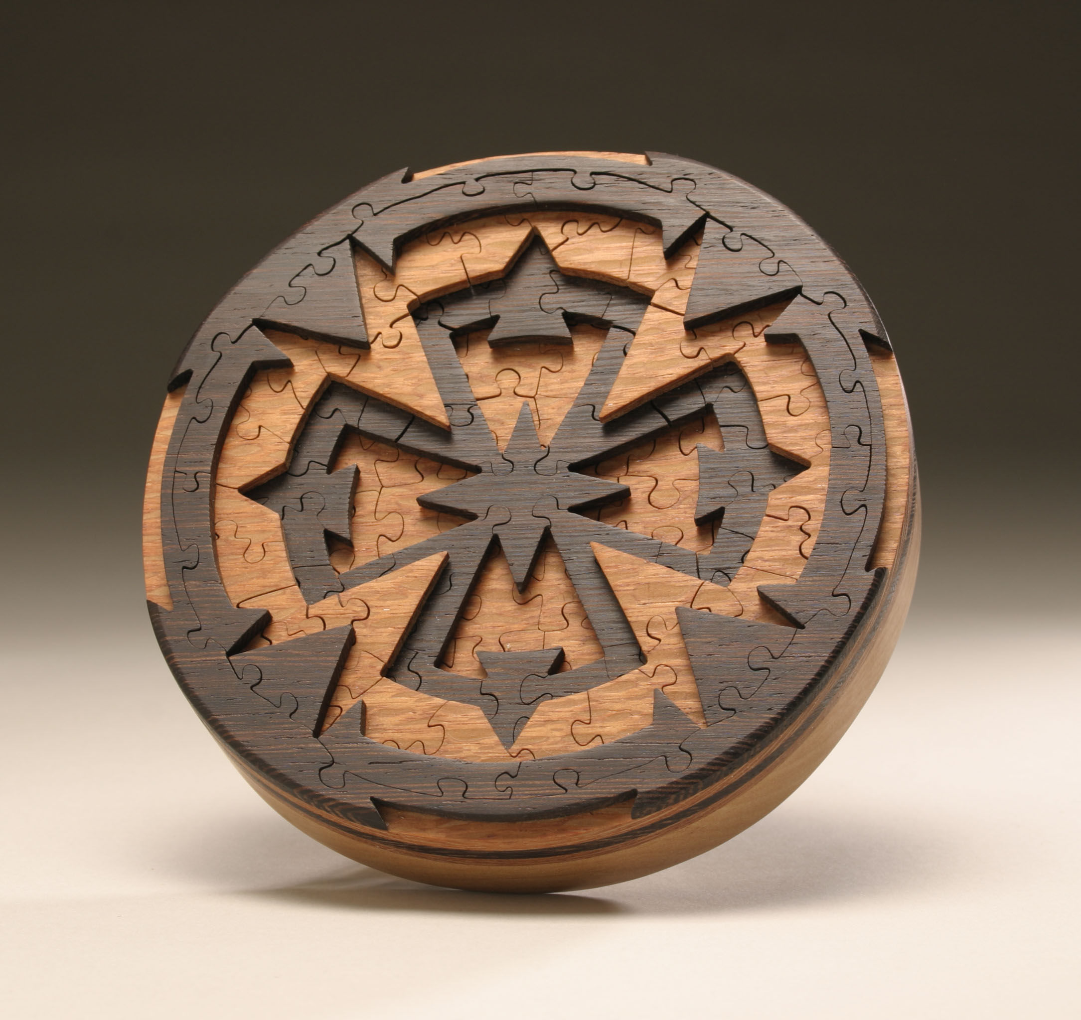

One of the concerns I have in creating a puzzle is the challenge. My puzzles range from single layer entertainment to multi-layered, complicated sculptural challenges.
One of the initial challenges comes form the fact that all the pieces are freehand cut, creating odd and irregular shaped pieces. The next challenge comes from the woods I work with—all naturally colored and  Scroll_Saw_Woodworking_Crafts_Issue_34_Spring_2009_1finished hardwoods. Additionally, all pieces are finished on both sides, so the puzzle solver needs to determine which is right side up before deciding where the piece belongs. There is no flipping all the cardboard sides down and all the picture sides up, like you do with the stamped out picture puzzles. I also cut lobes and sockets into the frames of the puzzles, that way there are no straight edges or definable corner pieces.
If all of this isn’t enough, many of my style puzzles are layered—a concept quite unique to my puzzles. The challenge is compounded when the various layers are made of the same wood, making it possible to assemble part of a layer in the wrong level of the frame. Most people only discover this as they progress further into the puzzle assembly.

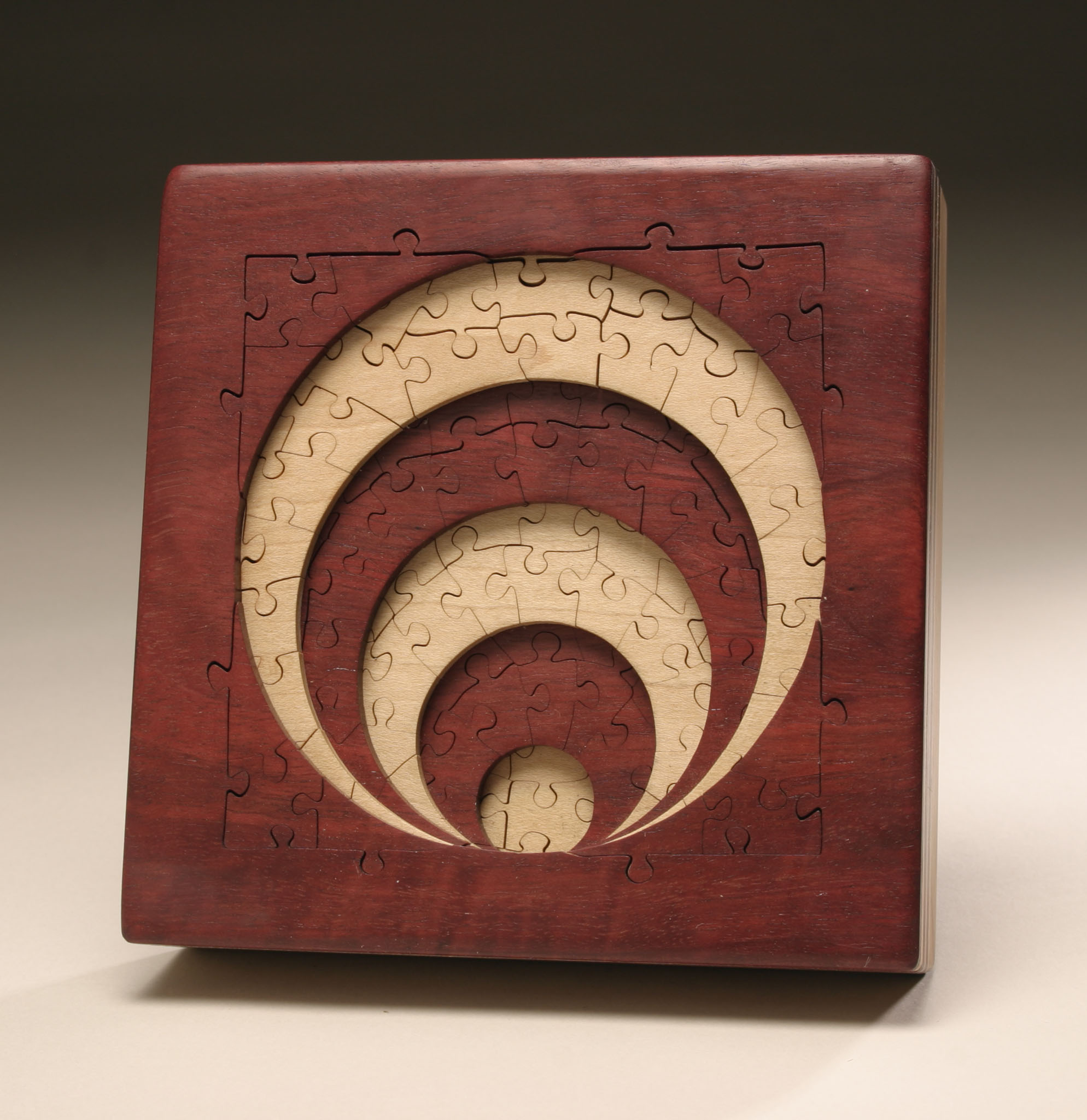

Layered RingsOne of my more challenging designs is a puzzle I called the “Layered Rings.” It incorporates all the previous challenges plus the illusion of negative space. The image created is similar to layers of gears or cogs. Every piece and all of the frame cuts have lobes and sockets cut into them, but not every piece is intended to connect into a matching cut, thereby further confusing the matter. This puzzle is recommended only for the serious puzzler.
I also create one-of-a-kind and limited edition sculptural puzzles. These puzzles are often architectural in form, stacking layers of pieces, creating three-dimensional sculptures mounted onto a base and often housed under a glass case. These puzzles are frequently frameless and held together by buttressing and/or fixed pegging from layer to layer.
